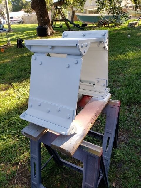

Making progress!
Got the porta bracket stripped down and repainted.

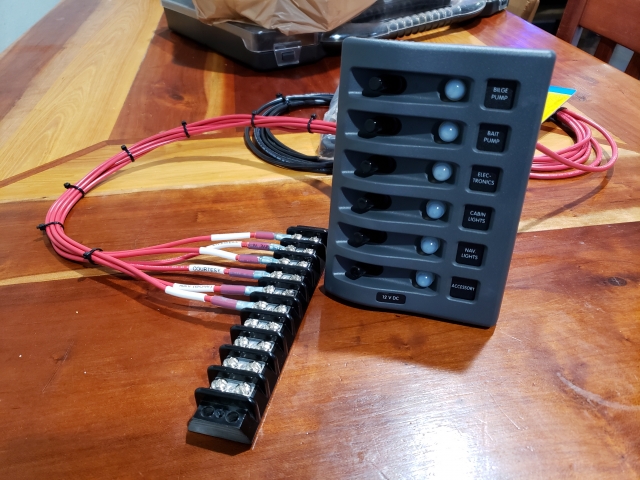

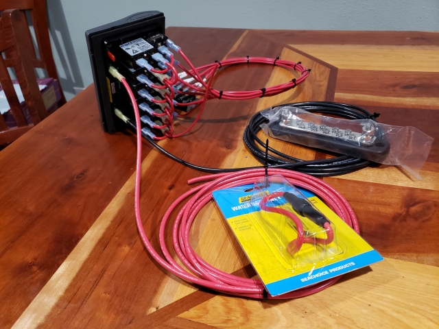

Started on the electrical while that tropical storm moved by and it was raining.

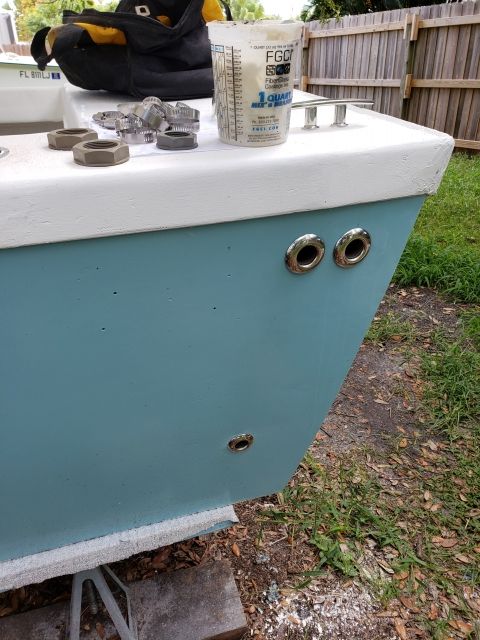

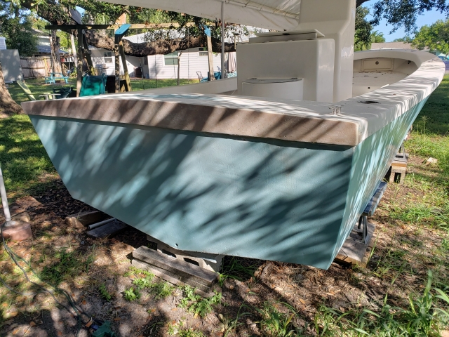

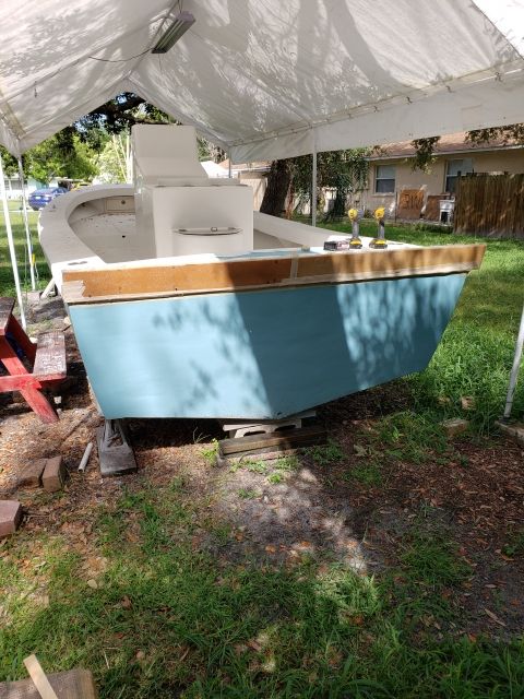

And then I got started on the rigging. I have enough rubrail to wrap around the whole boat so I decided to extend the lip around the transom so I could do that. I started by glassing a layer of 1/4" divinycell that I had leftover and then epoxied it to the back.
Then it was just a little shaping and fairing to blend it in and a coat of gel.
While that was drying I started drilling out the through hulls for all the pumps and drains along with the bow and stern eyes.

Got the rubrail installed, all the through hull fittings glued in place, bilge pumps and float switches screwed down and plumbed, and the bow and stern eyes installed today.
The deliveries have also been pouring in today. The hydraulic steering, wheel and the start of the n2k network arrived. I'll hopefully get started on all that soon.  :8):

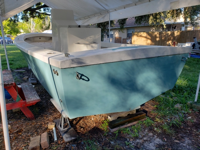

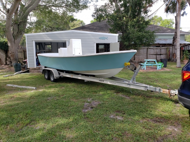

Finally got it off the stands!
