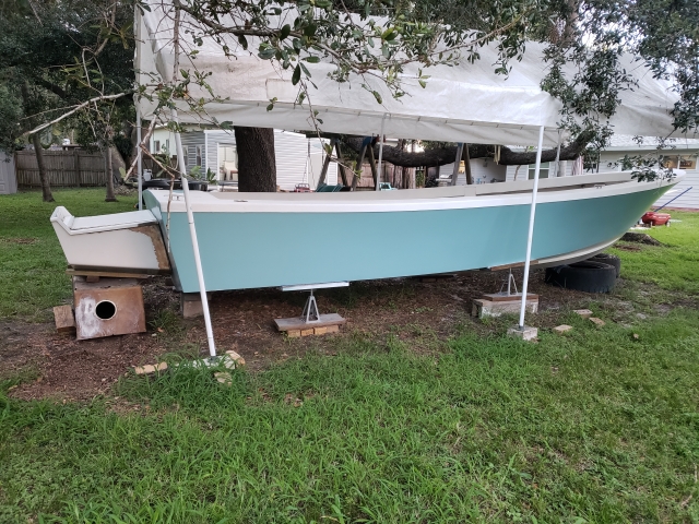

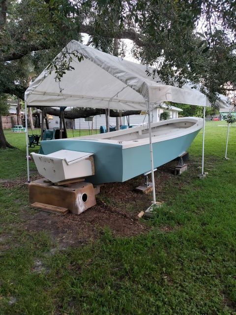

Is that a change in motor support?  The boat is looking great.
September 08, 2019, 08:57:21 PM
Reply #331
  • Posts: 579
Re: Mike's 77 22-2 Rebuild
« Reply #331 on: September 08, 2019, 08:57:21 PM »
Thank Rick. I didn't have anything yet. I've been keeping my eye out for something that would work - Porta bracket, Armstrong, big jack plate, I even considered building something, but this came up for sale just down the road from me and I couldn't pass it up for the price.

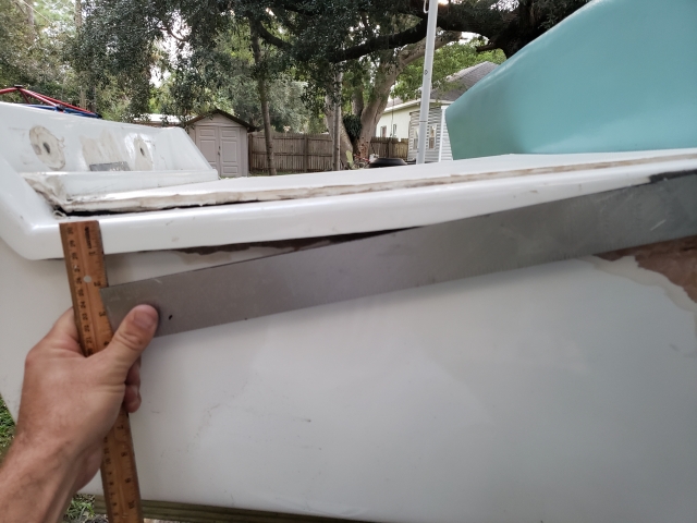

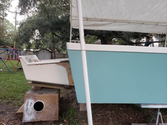

Before I do any clean up work on the bracket I want to make sure it will work so I propped it up against the transom to take some measurements and such. So, now the $2500 question. What do you guys think? I don't know the first thing about mounting a bracket, but it looks like it may have a bit too much negative angle. (If that's even the right term?)
At 24" out theres about a 2" drop. Should it be closer to 90° off the back?
Thanks for any advice

You’ll need to figure out the mounting height based on where you need your engine to mount.  The rule of thumb is that the engine needs to be raised 1” for every 12”” of setback.  So, a 30” setback bracket will require 2 1/2” of additional height 27 1/2” above the keel for a 25” shaft.  How high will you need to mount the bracket to achieve that?  Will the height still leave you with enough room for engine rigging coming out of the transom?
A second factor will be trim range.  There’s no question you’ll have a lot of negative trim, but will the upper trim position allow you to trim the bow up enough? probably, but I’d check to be sure.

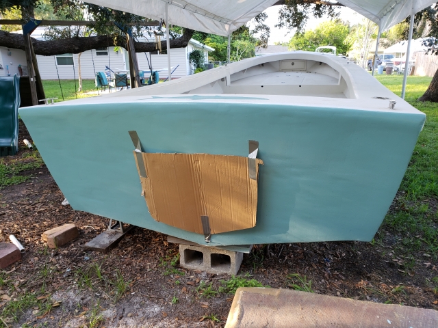

Thanks for the input guys. mshugg, I think I'll have enough room for the rigging while still being able to access the drain plug. For now I was more concerned with the transom angle than the height so I just used that box since it was sitting there. I cut out a cardboard template and mounted it about 27" from the bottom.
I will have to double check the trim range though.

It actually looks like you’ll need to mount it higher because of the downward slope of the bracket.  That will put the motor deeper in the water.

just a thought, but won't you want to run some boards parallel with the bottom of the hull extended back behind the transom, use that to set the motor cavitation plate height (as posted earlier raised 1” for every 12”” of setback).  Then figure out where the bracket needs to sit to hold the motor there.
At this point the transom angle vs. bracket angle is what it is, but don't measure perpendicular off the transom to set the motor height.  Sorry if I interpreted your previous post wrong maybe thats what you're already doing?
