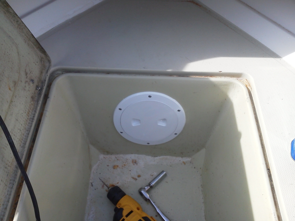

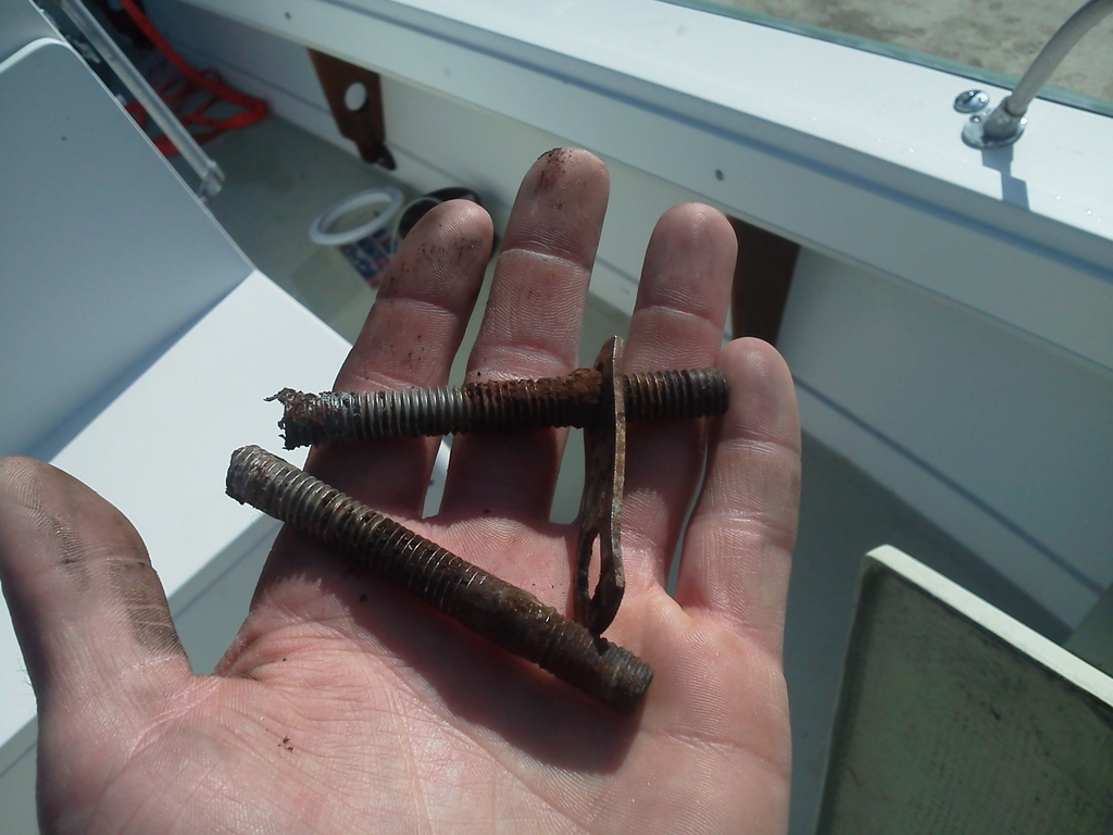

Dug into this Sunday AM.  Nuts on my eye were not loose, and the backing wasn't terribly rotten...my problems was the nuts were rusted almost completely away  :shock:

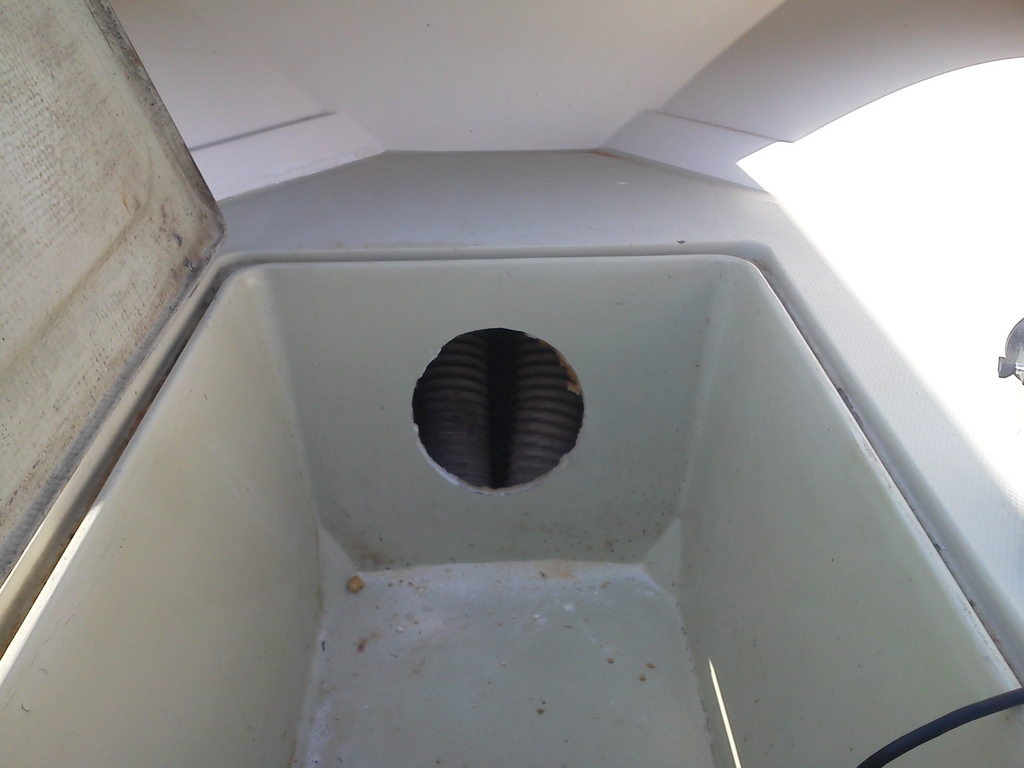

Cut a hole in the front of the ice/fish/cooler compartment sized to accommodate a 6" pie-plate.  Sawzall'd the old u-bolt off from the outside, punched the cutoff studs into the boat, pulled them out through my new access hole.

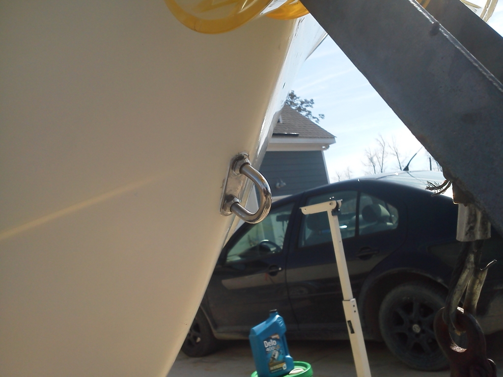

Then I cut a piece of anodized aluminum as a big backing washer and installed the new one.  Pie-plate installed and done  :thumright:

:thumleft: Nice clean job!  Looks great :salut:

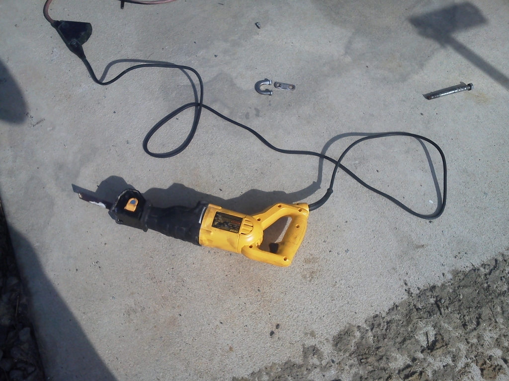

Note the relatively good condition (relative to the rusty crap that was inside) of the portion of the u-bolt that was outside of the boat...
And the sawzall is not my go-to cutting tool, but it seemed best for this application.  It's actually #4 behind Oxy/Acetylene, plasma cutter, and grinder  8)
