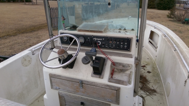

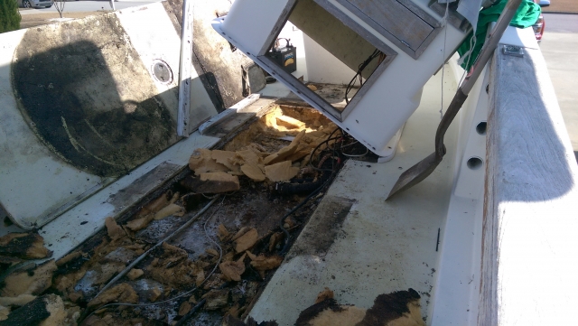

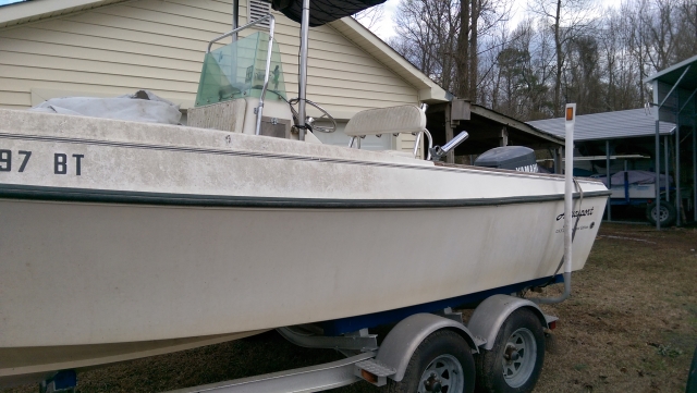

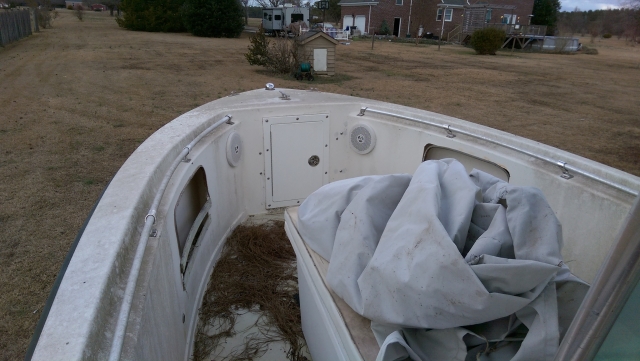

Decided to pick me up something to play with.  This CCP was in the seller's family since new.  The cap was removed around 10 years ago and the deck was replaced from underneath.  Transom was done at that time as well.  For some reason the tank and the rotten hatch over the tank were not addressed then :?:

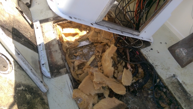

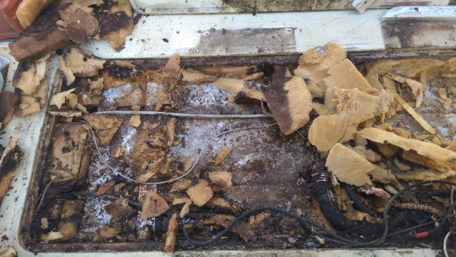

Pulled the tank hatch and to my surprise the tank was foamed in :a0004:  I have never seen a CCP with a foamed in tank.  It was a factory foam job!  The tank is also 73 gallons.  The brochure for the '78 says that it has a 50 gallon tank :?:  The tank has no plate identifying who made it?  Maybe the foam was experimental for this CCP.
This CCP is very solid and has a great deal of potential but needs a lot of work.
Anyway, have a new tank on order and re-coring the tank coffin hatch.  I will post more of my progress as I continue.
Here are some pictures before she was cleaned up.  She cleaned up nice.
